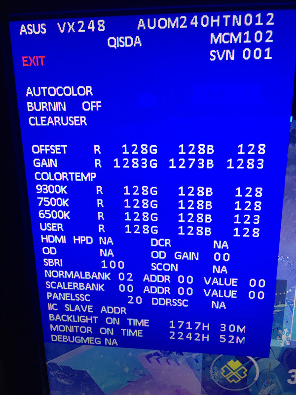

Hello i've tried to flash the EDID of my ASUS VX248H monitor but i can't i get write permission denied, i've read a topic where a guy says that he turn BURN IN mode to ON and it enables EDID Write Permission but it does just not work with my monitor, i also have no such option to enable EDID Write Permission on service menu.
Does anyone know a way to enable Write Permission on this monitor ? Thanks Service menu picture: ![]() |

I've heard of burn-in mode disabling write protection, but that might not apply to your monitor. The only other way I know is to physically modify the hardware to remove the write-protection pin from the EEPROM chip: https://blurbusters.com/zero-motion-blur/hardware-mod/

(01-20-2022 05:27 AM)ToastyX Wrote: I've heard of burn-in mode disabling write protection, but that might not apply to your monitor. The only other way I know is to physically modify the hardware to remove the write-protection pin from the EEPROM chip: https://blurbusters.com/zero-motion-blur/hardware-mod/ Yes but i tried it for the BURN IN mode i set it to ON i stay on the service menu and tried to flash but i still got the error, i tried exiting the service menu with it ON also but it stills get write error. For the physical way, do you think my monitor have the same chip ? if yes im ok to try it ! =) Thanks Edit: Quote:./edit-rw -w -s 0.01 X < edid_120hz-lightboost-only.bin PS: i dont tried to use this method of small delay, do you think the error comes from here ? on the tutorial i've watched the guy does not use this method of small delay and it works ? |
