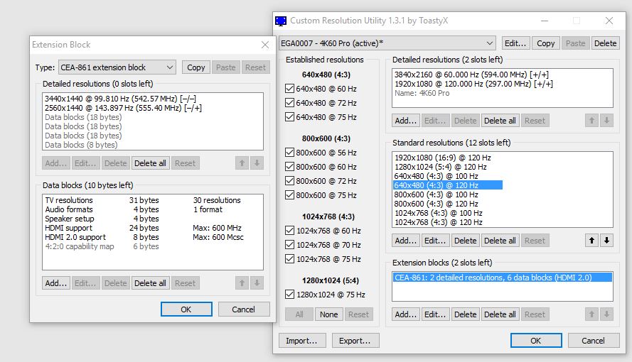

Anyway, CRU fixes this problem by allowing me to set up a custom resolution for the capture card so it'll run at the same refresh rate as my monitor. 3440x1440, 100hz rather than 60hz over HDMI. Works perfectly... except for audio. It was dead silent.
I read the instructions for adding audio support, followed them, and it started popping/clicking. I tried editing the existing extension block, removing one of detailed resolutions there, and adding my own and that did the exact same thing. The moment I go back to a standard resolution, audio via HDMI works fine.

HDMI audio is mainly meant to be used with TV resolutions. For other resolutions, you have to make sure the blanking is large enough to accommodate the audio. Try setting the totals for 3440x1440 to 4000x1500. That should get you exactly 600 MHz pixel clock at 100 Hz. If that doesn't work, the capture card might not be able to transmit HDMI audio correctly at that resolution or refresh rate.
