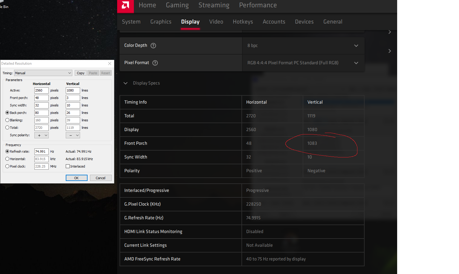

I do know that AMD is misreading Front Porch since I used CRU. Maybe this info is useful to you?
[Image: sgX54sj]
