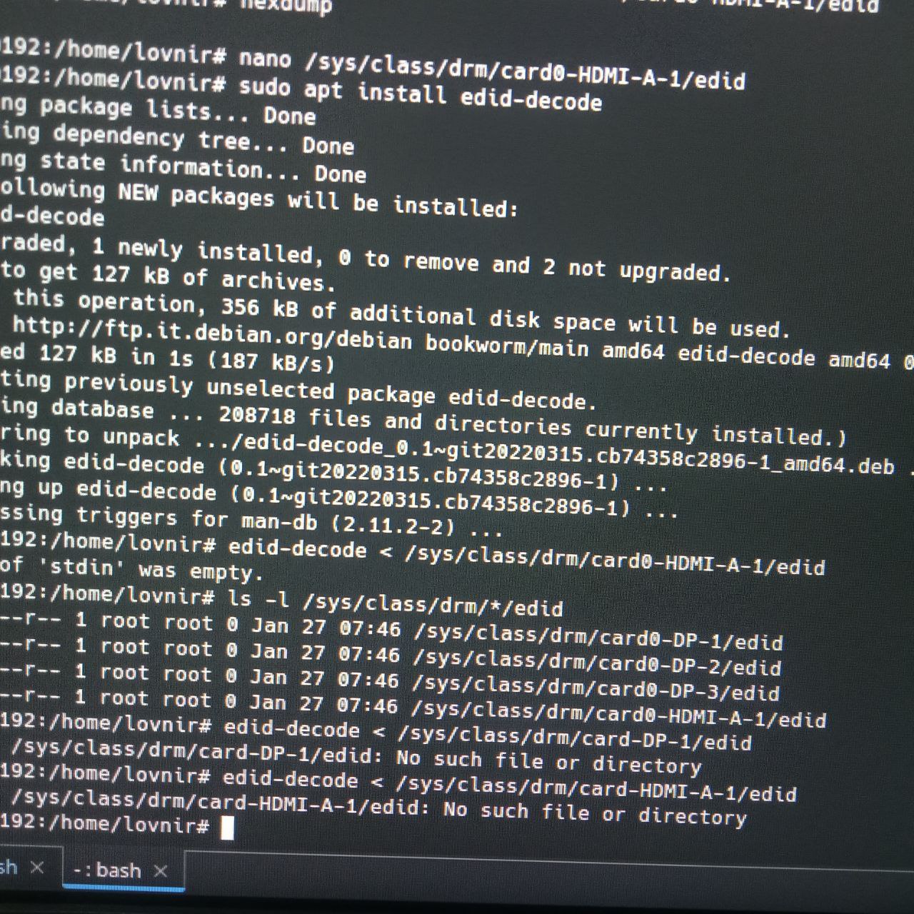

The edid-test needs to be run without the adapter and without any EDID overrides. Do you have Windows or only Debian? I just need some way to get the monitor's HDMI EDID. Debian has a read-edid package with get-edid, but it might not work if the EDID is corrupted.

Also you might have different results with the Nouveau driver vs. NVIDIA's proprietary driver. NVIDIA's driver is less forgiving with EDID errors, so it might not detect the monitor if the EDID is corrupted.
If that doesn't work, the best option to confirm if the EDID is corrupted is to use EDWriter for Windows with an AMD GPU, which can read corrupted EDIDs directly from the monitor (read EDID and save to file): https://www.monitortests.com/forum/Threa...yID-Writer

you are correct it doesn't have any EDID sorry for reiterating to be concise after plugging it in during logon screen and unplugging vga adapter these are the screen shots, I can't open anything I had to enable the konsole shortcut then restart pc and do this
no EDID given by monitor
