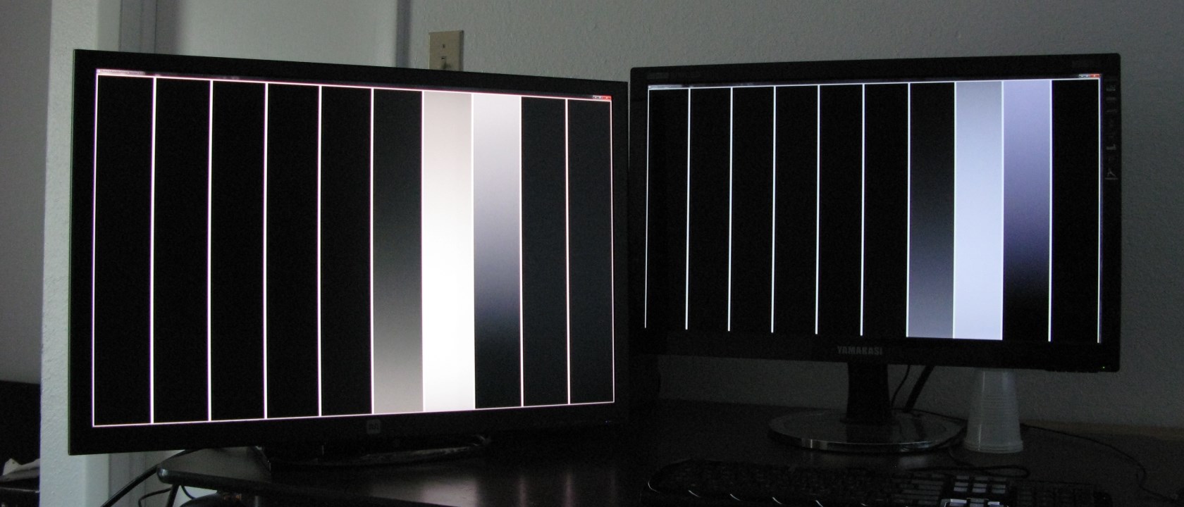

Monoprice (left) vs. Catleap (right) at 2560x1600 @ 85 Hz:
A passive DVI splitter was used for this test to eliminate software factors. The splitter cannot handle higher pixel clocks because of the reduced signal strength, so the test was done at 2560x1600 @ 85 Hz.
The Catleap is a 2560x1440 monitor without a scaler, but it can display 2560x1600 with the bottom 160 pixels cut off. The test was done at 2560x1600 to eliminate scaling as a factor on the Monoprice monitor.
Result: The Monoprice monitor skips frames at 85 Hz, while the Catleap does not. The Monoprice is also two frames behind (~23.5 ms) in both photos.
Monoprice at 2560x1600 @ 120 Hz:
The monitor was connected directly to the video card to test 2560x1600 @ 120 Hz.
Result: The Monoprice skips every other frame at 120 Hz, effectively making it 60 Hz. This is visible on the test even without a camera.

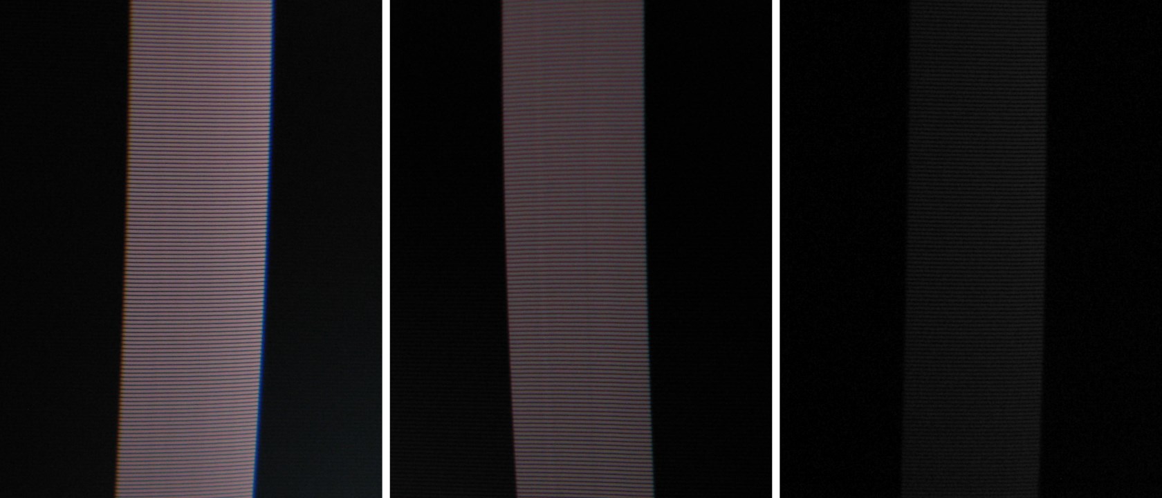

PWM Flicker
Monoprice @ 100/50/0 brightness:
Result: The backlight does not flicker at any brightness level.
