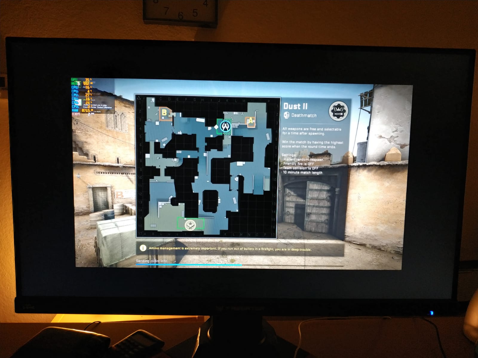

Hello guys,
so after hours and hours of skimming through Google and trying all kinds of stuff I've now finally registered here as a last resort, here's my setup: Acer Predator XB271HU (connected via Displayport to a) Radeon R9 280X Win 10 Pro Latest AMD driver 19.4.1 installed So this Acer monitor has a 1440p native resolution and supports up to 165 hz (when activating it's 'OC' mode in the monitor's OSD), otherwise 144 hz. Whenever I try to run a game with a 1080p resolution @ 144 hz, it will not scale up the image to a full screen no matter WHAT I try within the AMD Radeon driver or the monitor's OSD. It's like the scaling option is stuck to "Scaling Mode: Center" Here are two images to show you what I mean: CS:GO @ 1080p ![]() Old Command & Conquer @ 1080p ![]() My GPU scaling option within the Radeon drivers is currently set to 'off' however it doesn't matter if I set it to on and pick any of the scaling mode options. It won't scale it to fullscreen. There's also an OSD option on my monitor: 'Wide Mode' can be set to either Full, Aspect or 1:1. Changing these options has actually never changed the image I'm seeing on my monitor and I've tried it while in-game, on desktop, using different resolutions / hz so I don't even know why the option is there when it's not doing anything. But now comes the really weird thing: I'm running 1440p at 144 hz as my native / desktop resolution. As soon as I decrease it down to 60 hz within Windows display options, the whole GPU scaling will work perfectly fine and I'm able to play 1080p enlarged to full screen , but with 60 hz only. Whenever I increase that to anything above 60 (I have 85, 100, 120 and 144 hz available in the dropdown), it won't scale the image and I end up with the configuration you see on my screenshots. I will also add that if I pick a 4:3 resolution of up to 1024x768, everything will work just fine as well (I'll have a 'full screen' with black bars left and right only, running at 144 hz, which is just the way it should be). Does anyone know how to fix this? ![]() |

I remember AMD's driver having issues with GPU scaling at certain resolutions, especially at higher resolutions/refresh rates with older cards like the R9 280X. Newer cards like the RX 580/570 seem to have less issues scaling with the latest drivers, so it might be a hardware limitation of older cards.
I don't know why the monitor would have a "Wide Mode" scaling option because G-SYNC monitors usually can't handle non-native resolutions without GPU scaling. If the monitor can actually scale 1080p @ 144 Hz itself, you'll have to add it with CRU to use the monitor's scaling options. |

Resolutions listed in CRU are sent to the monitor, so the monitor handles the scaling for those resolutions unless GPU scaling is enabled in AMD's driver. The driver also adds some common lower resolutions as scaled resolutions, so the GPU handles scaling for those resolutions. If you add 1920x1080 @ 144 Hz with CRU, it will be sent to the monitor, but as I said, the monitor might not support it. If you edit the extension block, you can see the other resolutions and data blocks the monitor has defined. The pixel clock patcher does not affect DisplayPort or scaling, and it's easy to undo by running it again. Upgrading or reinstalling AMD's driver also removes the patch. As I mentioned, AMD's driver has had issues scaling some resolutions with older cards, especially at higher resolutions and refresh rates, so I'm not surprised by this. Newer cards like the RX 580/570 might not have the problem, but you might be better off getting an NVIDIA card so you can take advantage of G-SYNC, and NVIDIA typically doesn't have scaling problems like this.
