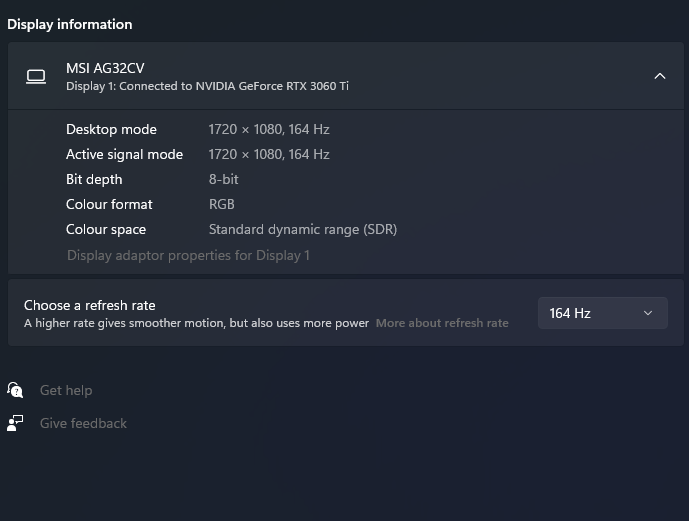

Wassup yall, so i've been trying to run 1720x1080 for fortnite on my 165hz monitor however everytime i get to the list all modes stage and i click the 1720x1080 resolution with 165 hz this happens to my pc (shown in attachments)
the screen and font gets real blurry and its impossible to read

these are the values, see anything wrong?

do me a favour and try putting in the refresh section (hz) 164 and try it again.
After u applied the new change restart your pc and try out the resolution on your desktop.

THANK YOU SO MUCH THAT WORKED i now only have black bars i need to get rid of, i've tried all the options on nvidia full screen etc and i still have the black bars do u know how to fix that?
this is my current settings on nvidia control panel

i think i have found the issue my refresh rate on nvidia keeps going back to 165 when i put it to 164 it shows on the preview that i will have no black bars but when i press apply it goes back to 165 and the black bars appear, if im able to keep the refresh rate on my nvidia to 164 then im sure it would work nicely

You have it set to use display scaling. The scaling modes are for GPU-scaled resolutions only. Any resolutions you add will be scaled by the display, so you'll have to check the monitor's menus for scaling options. The preview in the control panel is just there to show how the scaling mode will affect the resolution and refresh rate you specified. It's not a setting.

just a quick update making my monitor 16:9 screen size fixed my problem so thank you both for the help along the way preciate yall <3
