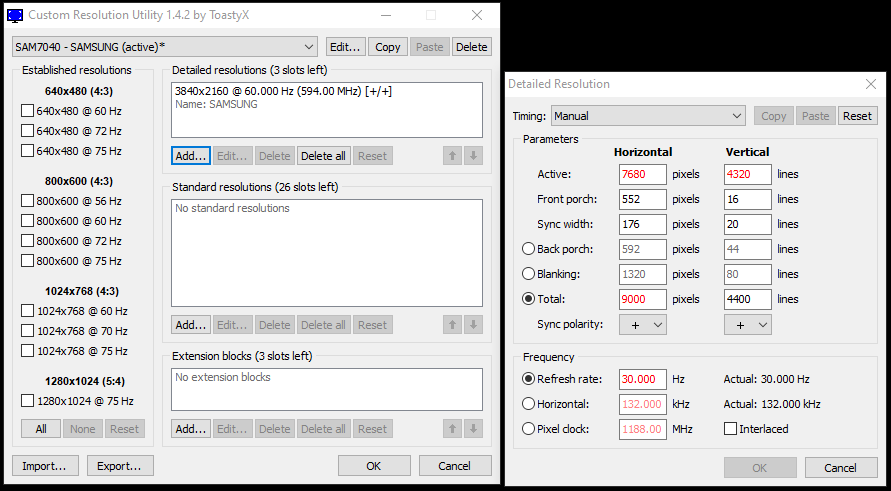

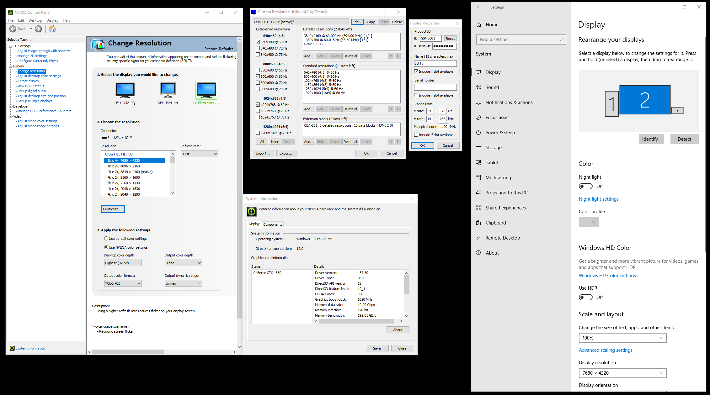

CRU is not allowing me to set an 8k resolution in the "Detailed Resolution" form on my W1050 computer (See attached picture); I believe the red fields in the form are disabling the "OK" button. I am using 8k hdmi to hdmi on a Samsung TV, model QN65Q850TAFXZA.
Here are the 3 Computers I am using to debug:
  • H1050 ~ home computer
  • W1050 ~ work computer
  • S1030 ~ server
Basically these are Intel custom builds with nVidia GTX graphics cards with the corresponding chipsets of GeForce GTX 1050 or 1030; H is home, W is work, and S is server. ** Suprised me that the nVidia GTX 1030 was able to do 8k **
The H1050 and S1030 computers both work at 8k on the Samsung TV; they see the 7680x4320 resolution, set the resolution, and display at both 30Hz and 25Hz; I am using an 8k hdmi cable rated for 48Gbps.
Problem is that the Samsung 8k TV is for my work computer, and does not show the 7680x4320 resolution; that is where CRU came into the picture. I have used my other computers to prove that the Samsung TV and the HDMI cable are working as expected.
Additional Info:

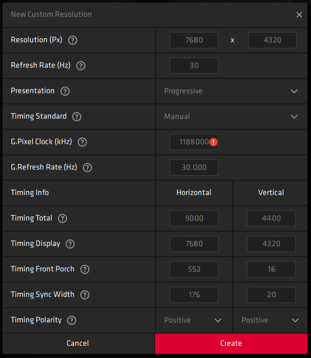

nVidia Control Panel also does not allow me to create a custom resolution on the work computer; the test button just says the 8k resolution is not supported.

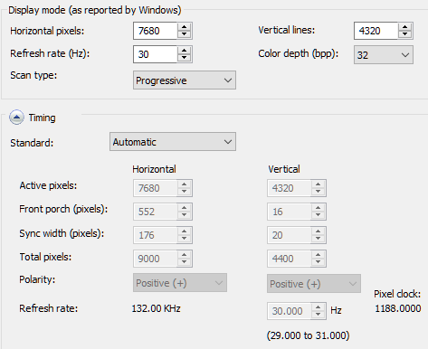

I was able to get the timing information from both my H1050 and my S1030 computers using the nVidia Control Panel, and they match as expected. The values in CRU and nVidia Control Panel also match.
I have also replaced the GTX 1050 with a GTX 1650 and updated the drivers, with the same results.
Thanks in advance...

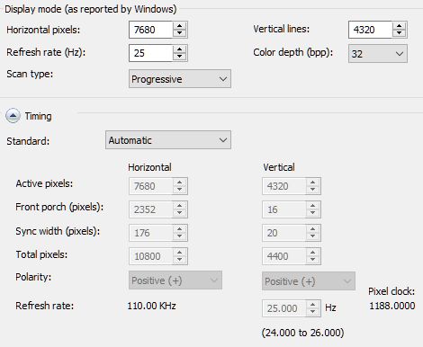

I attached the timing information as reported by the NVidia Control Panel for the Samsung 8k TV

You can't add resolutions greater than 4095x4095 or 655.35 MHz pixel clock with EDID detailed resolutions. You have to add it in a DisplayID extension block or as a TV resolution in a CEA-861 extension block, but that won't help because it doesn't make sense to add a resolution that the TV already defines. Where is the original extension block? You are missing the data blocks required for HDMI 2.0 to work, and the original extension block probably contains the 8K resolutions already. Also, 7680x4320 @ 25/30 Hz requires HDMI 2.1, which the GTX 1000-series doesn't support, so I don't know how it's working on the other two machines unless it's set to use YCbCr 4:2:0. HDMI 2.0 is limited to 600 MHz pixel clock, but YCbCr 4:2:0 uses half the bandwidth, effectively allowing up to 1200 MHz. For that to work, it has to be added as a 4:2:0 resolution in a TV resolutions data block with "4:2:0 resolutions" enabled, if NVIDIA supports 4:2:0 with 8K resolutions.

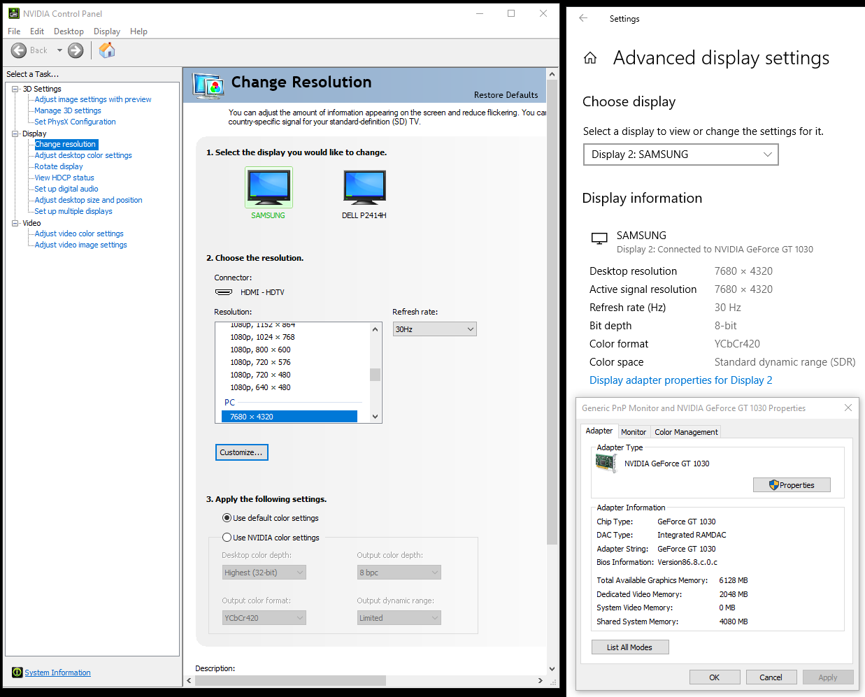

I have attached a screen shot of the S1030 CRU SAM7040 @ 7680x4320 30Hz YCbCr420 resolution, which is under "PC" resolutions, and not "Ultra HD, HD, SD" resolutions in the NVIDIA Control Panel.
When connecting to the Samsung TV, the TV recognizes the computer as a PC. I believe it is sending the PnP monitor information at that point. Depending on the TV setting, SAM7040 is the ID when configured for 8k input; SAM703E is the ID when configured for 4k input. Samsung refers to this as "Input Signal Plus", HDMI #4 on this model is supposed to be 2.1 compliant. The first three hdmi ports are 2.0b compliant. I am only testing on HDMI #4, but it does not really matter because I think only the nVidia 30 series has HDMI 2.1 ports. I have attached 2 screen shots that confirm the "Input Signal Plus" TV setting in CRU.
Because the TV is telling the PC that it is a "PC" monitor, I believe that is why the PC resolution is available on the S1030 computer under the PC resolutions.

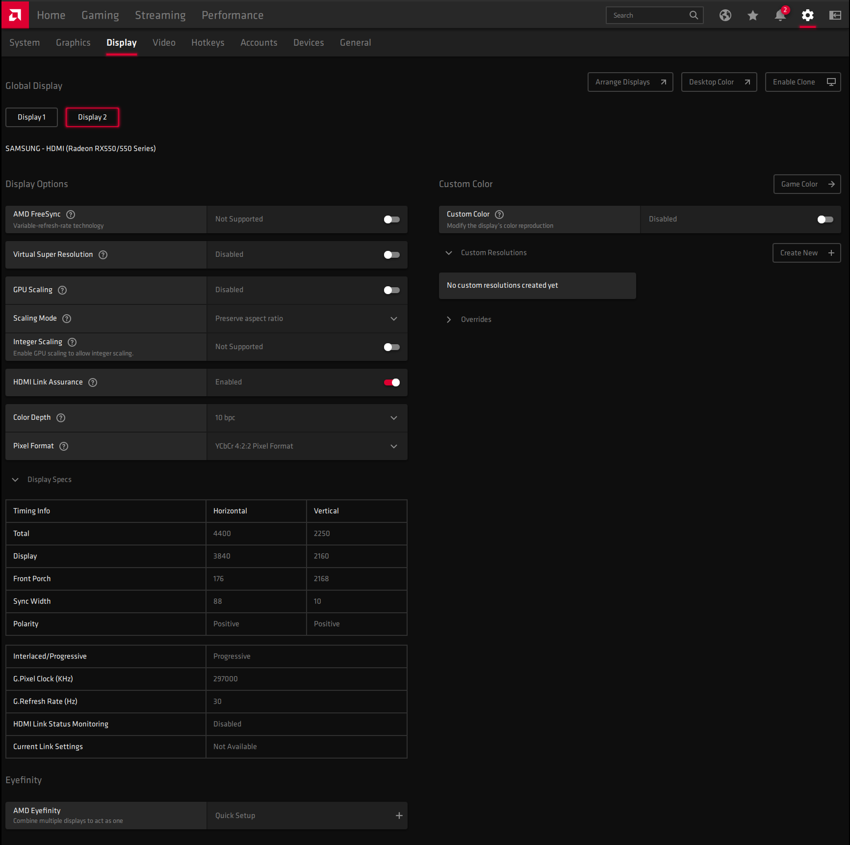

Radeon RX 550 card reports the "Display Specs" as 4k for the Samsung TV, see attached screen shot. There is no option to select a Pixel Format as 4:2:0; RBG, 4:4:4 and 4:2:2 are all options.
Radeon RX 550 option to create a "Custom Resolution" has the same limits as the nVidia Control Panel; it seems that I need to be able to create a custom resolution and Pixel/Color format of 4:2:0. See attached screen shot. Neither the AMD or nVidia settings allow for customizing the resolution in conjunction with setting the pixel format.

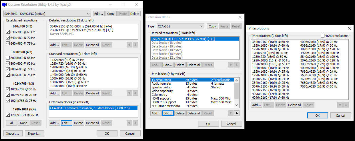

When I look in CRU, it seems that the 4:2:0 format and the 7680x4320 resolutions should be available. However the changes I make in CRU, don't seem to translate to the display control panels as options, so there is a good chance that I am not doing something correct in CRU.

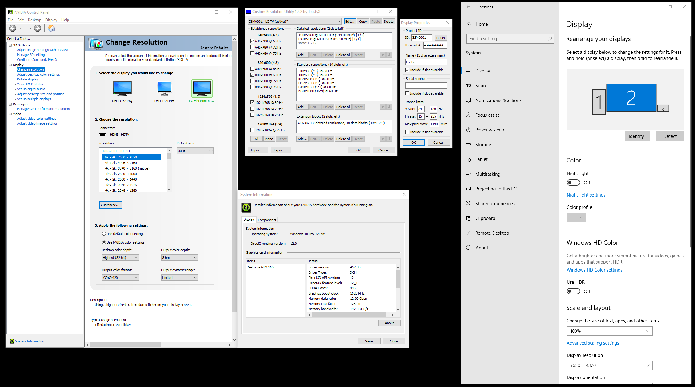

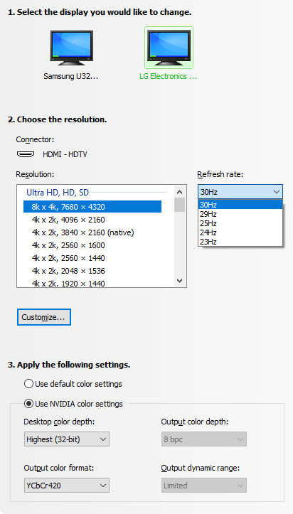

What does not make sense to me is why the LG 8k (GSM0001) has CRU "4:2:0 resolutions" of 60Hz and 50Hz for 8k, but the refresh rate in nVidia Control Panel is 30Hz down to 23Hz. See attached pictures.
To test that CRU changes are being updated correctly on W1650, I removed some of the 1080p resolutions , as expected they were removed from the nVidia Control Panel.
I have added to the SAM7040, in the existing CEA-861 Extension Block, "4:2:0 resolutions" similar to what was on the LG 8k. They do not translate to 8k settings in the nVidia Control Panel.
