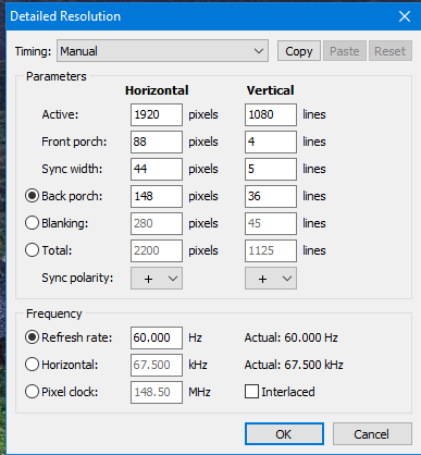

I've bought an LG 23MP68VQ-P monitor. I have an AMD card so I enabled Freesync, but after that I noticed the blue colors are pixelated (like there is a grid drawn on them or something) at 75 Hz. If I lower it to 60 Hz it's fine again, I tried to experiment with custom resolutions and it's around 65 Hz when this issue starts to present.
What do I have to do ? I'm using with HDMI with amd R9 390.
Edit: It's very noticeable with some colors If I look closely, but not just blue, yellowish.
60hz mode:
75hz mode
Looks like the issue starts happening when I exceed 158-159 MHz pixel clock.

I don't think you can do anything about that. The panel controller might have a limitation that causes faint lines to appear at higher refresh rates. I would return the monitor if possible and get a different model.
