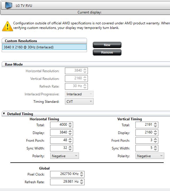

I am using display port on a dell precision m6700 with amd 6000 video card. I had things working but windows got corrupted and I lost my settings. I am trying to use a custom resolution but it comes back way to large and I get no task bar. Here are the settings I am trying to use
horizontal timing
total 4000
display 3840
front porch 48
sync width 32
polarity negative
vertical timing
total 2191
display 2160
front porch 3
synch width 5
negative
refresh rate 30hz
Should I be trying some much different numbers.
04-26-2017, 08:23 PM
RE: Custom Resolution for LG monitor

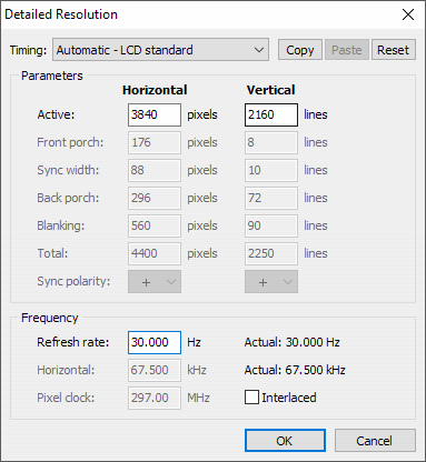

The first problem is why do you have it set to interlaced? It should be progressive. That might be the problem. If not, you probably need the CEA-861 timing standard, but AMD's custom resolution dialog doesn't have that as an option. CRU will show the correct values with the "LCD standard" and "LCD native" timing options.

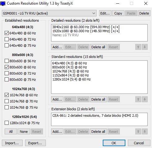

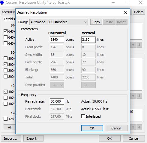

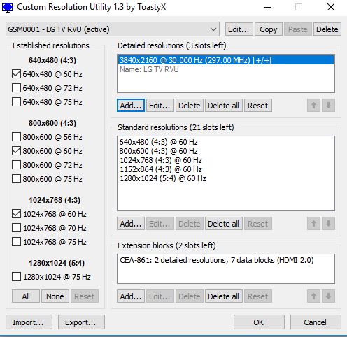

I sent attachments of what I get when I use your tool. Before image, then I delete the current stuff and add just the standard last image and then I try a restart64 and My 4k monitor does not work. I am missing something important..

You said you are using DisplayPort, but the monitor is reporting HDMI 2.0. Are you using an adapter? Is it an active or passive adapter? If it's passive, you need the driver patch to exceed 165 MHz pixel clock. Normally you shouldn't have to add 3840x2160 @ 30 Hz because most UHD TVs already define it, often in the extension block. You can also try putting the same numbers in AMD's custom resolution dialog instead of CRU and see if that makes a difference.

It is a active adaptor and I tried putting in numbers in amd and no luck.. This exact hardware combo was working great at 4k before Windows got corrupted and had to reload it so I know it is software.

I tried putting them in AMD and also get same results of no display on that monitor. Seems like I only get display if I use interlace.
