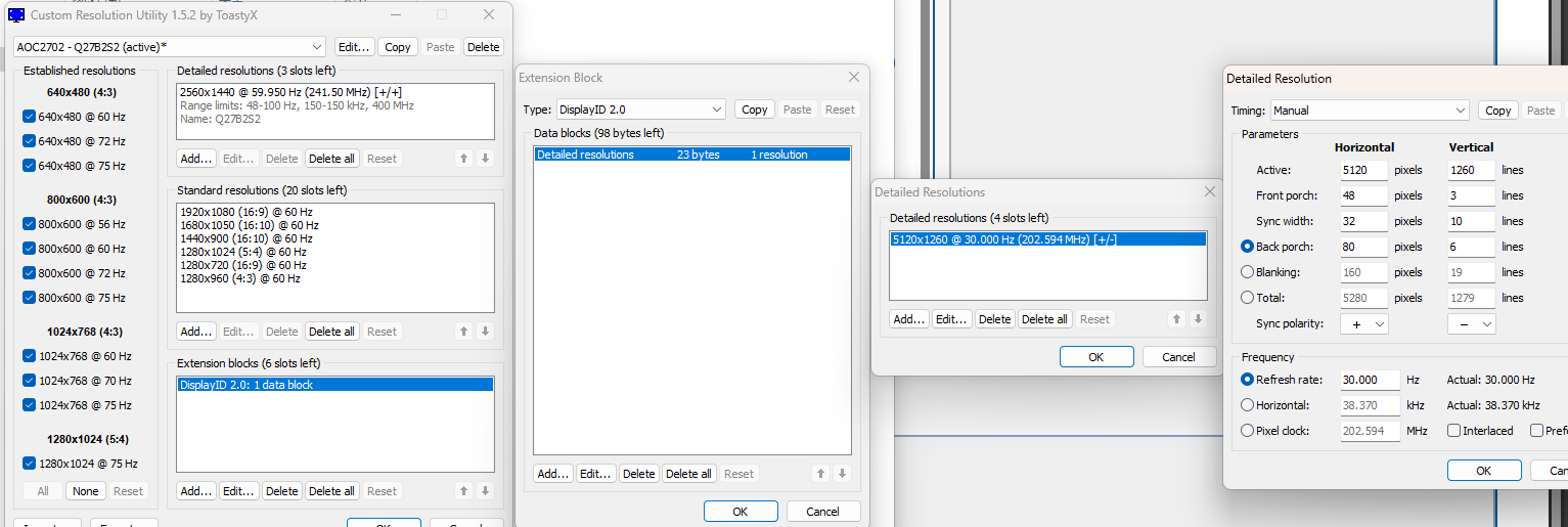

(2) I use the CRU to generate a correct 5K resolution as image. But sometime it didn't work. Here is my test condition:

when in A case, it works, but it will firstly use EDID's resolution, and i need go to the NVIDIA control panel to set the 5K resolution. If here any method to set the 5K resolution as default?
when in B case, it didn't work at all. I use the AMD software: Adrenalin Edition to
create the corresponding resolution, it won't work well. I suspect that win10 has the limit with EDID which has a DisplayID 2.0 extension.
when in C case, it also didn't work. My classmate suspects it's arm firmware chip's question. But i am really not familiar with Arm chips.

A) You can delete all the other resolutions. Then it will only use the 5120x1620 resolution.
B) HDMI needs an HDMI data block in a CTA-861 extension block, which should be the first extension block, but then you won't have room for the DisplayID extension block with only 256 bytes. You'll need 384 bytes for two extension blocks. The max TMDS clock in the HDMI data block should also be enabled and set to 340 MHz. If the monitor has DisplayPort and the laptop has a USB-C port that can support a display, you can use a USB-C to DisplayPort cable instead of HDMI. Windows 10 shouldn't be a problem.
C) I don't know how iPad handles external displays. DisplayID 1.3 might work better. The chip shouldn't matter. The graphics driver handles the displays.
