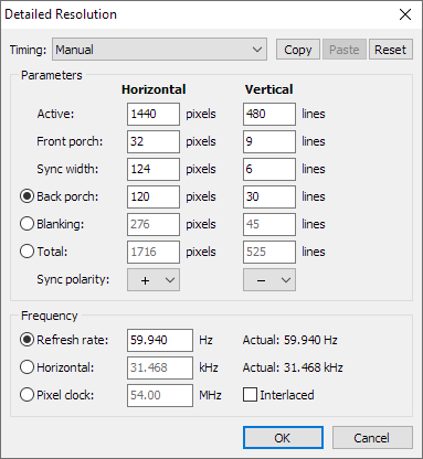

This is tricky because AMD's GPU scaling will only scale up, not down, and I don't know what timings that TV will accept. You should be able to center 720x480 within a higher resolution by setting GPU scaling to center in AMD's control panel.
You might be able to trick the TV into accepting a custom resolution if the totals and pixel clock match a supported resolution. There is a 1440x480p resolution intended for TVs that might work:

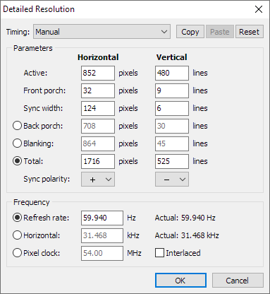

852x480 based on that (even numbers might work better):

That worked! Had to setup AMD's panel to "Full panel" stretch for 852x480 (on 1440x480) to work, thanks a lot!!!
