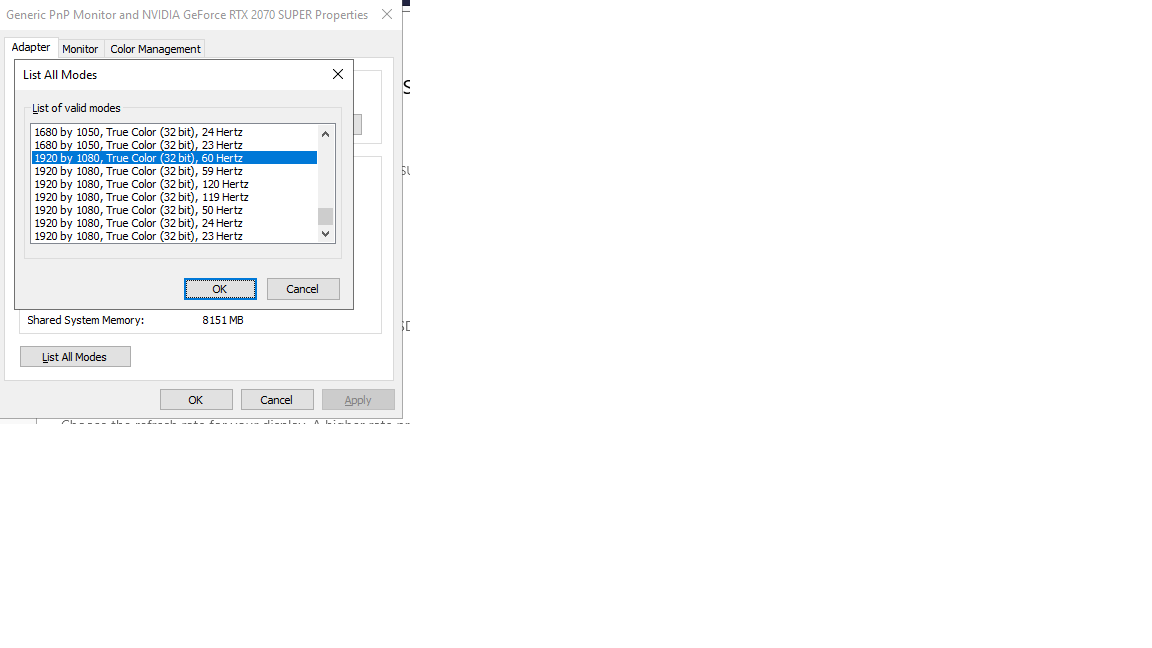

I'm confused. First you say 1280x1080 max, then 1280x1024 max, then you say 1920x1080 is available but 60 Hz only, but then you also say Windows only lists 1920x1080 @ 24 Hz.
What is the highest resolution that Windows lists? Post a screen shot.
What is the highest resolution that the NVIDIA control panel lists? Post a screen shot.

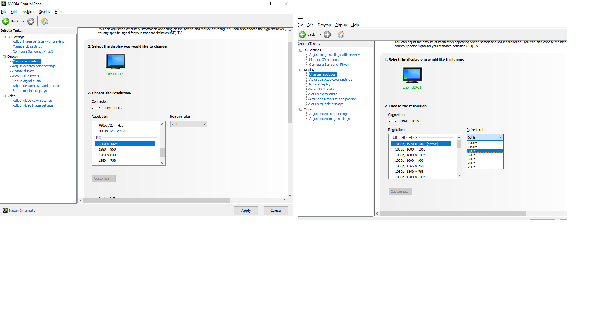

Typo it was 1280x1024. Yep i said 1920x1080 60hz is available, but then explained in Ultra HD, HD, SD mode only! It is called TV mode too. Not the PC mode! I am not sure, what it lists in windows mode now in Windows. As it changed couple times, as i was reinstalling drivers. And because i added 2 times 120hz modes. So these wouldn't count, so there are listed now 2 120hz modes! But it lists also 60hz mode, which can be TV mode and is probably TV mode only! As in CRU, there is only entry with 1080i for 1920x1080 60hz. I don't think that's PC resolution.
So if it handles 1920x1080 60hz in Ultra HD, HD, SD mode, i don't see any reason it could handle 1920x1080 60hz in PC mode!
I don't even need full hd. Problem is i don't want to mess up DPI scalling, or something. When i will run VR headset at the same time. I will use my TV in worst case as monitor. But then i can't control my PC at all, because no table and it is annoying! Or you can tell me if running at 1280x1024 75hz could create some problem for VR, or overall in system. As this is pretty weird resolution. And we know windows is full of bugs...
I included screenshot: it is safe to say highest mode is 1920x1080 60hz in windows. I added 2x 1920x1080 120hz modes. So these doesn't count and doesn't work: HDMI no signal.
In nvidia same these 2 120hz modes are added and doesn't work.
So windows: highest it says it supports is 1920x1080 60hz for Ultra HD, HD, SD (TV mode)
And for PC, it says in nv control panel max 1280x1024 75hz.

(12-22-2020 10:36 PM)empleat Wrote:  Typo it was 1280x1024. Yep i said 1920x1080 60hz is available, but then explained in Ultra HD, HD, SD mode only! It is called TV mode too. Not the PC mode! I am not sure, what it lists in windows mode now in Windows. As it changed couple times, as i was reinstalling drivers. And because i added 2 times 120hz modes. So these wouldn't count, so there are listed now 2 120hz modes! But it lists also 60hz mode, which can be TV mode and is probably TV mode only! As in CRU, there is only entry with 1080i for 1920x1080 60hz. I don't think that's PC resolution.
There's no difference. That's an NVIDIA-specific designation. "Ultra HD, HD, SD" means 2160p, 1080p/i, 720p, 576p/i, 480p/i resolutions. 1920x1080 is 1080p. You're not being limited to 1280x1024. 1920x1080 @ 60 Hz is listed in the Windows display settings in your screen shot. It should be listed in CRU. Export a file and post it here so I can see.
The monitor only supports 120 Hz with DisplayPort and dual-link DVI. There's no way to make it accept 120 Hz with HDMI.

(12-23-2020 01:12 PM)empleat Wrote:  You are mistaken there is difference!
What exactly is the difference then? You keep saying "TV" and "PC" mode, but there's no such thing. There's nothing in the EDID that says whether a resolution is a TV or PC resolution. Only NVIDIA lists them separately. NVIDIA does not even call them TV resolutions. They are HD/SD resolutions. 1920x1080 @ 60 Hz is already listed under HD/SD resolutions. Why would you expect the same resolution to be listed under PC resolutions? Windows doesn't support more than one of the same resolution.
(12-23-2020 01:12 PM)empleat Wrote:  In CRU is only 1080i (which is TV resolution according wikipedia) and interlaced... No wonder it feels so laggy. I never used Ultra HD, HD, SD (TV) resolution, because it lags as hell! There is no 1080p resolution...
Your new screen shot shows 1080p is the first detailed resolution! Why do you keep saying there's only 1080i? Your other screen shots also clearly show 1080p is available, so it's not using 1080i like you assume.
(12-23-2020 01:12 PM)empleat Wrote:  Even from this post. Nvidia staff sora says: Ultra HD is for TV specs. It is not meant for PC! Clearly there is a difference, because this resolution creates lag as hell.
Sora is not NVIDIA staff. There's no such thing as "TV" and "PC" specs. TVs and PC monitors using HDMI both follow the same standards. Yes, TVs and PC monitors sometimes use different timing parameters, and the next version of CRU will have separate timing options, but 1920x1080 @ 60 Hz is the same for TVs and PC monitors. The options will be mainly for 4K/8K resolutions and 100/120 Hz resolutions because TVs using HDMI and PC monitors using DisplayPort often use different timing standards for those resolutions.
If you really want everything to be listed under "PC" resolutions, then delete the extension block. Then NVIDIA will treat it like a DVI monitor and disable all HDMI features.
