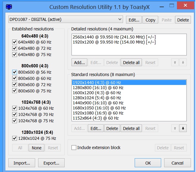

(10-03-2013 09:37 AM)ToastyX Wrote:  1920x1080 shouldn't be listed in CRU either. Did you add it or was it already there? The QNIX can't handle anything other than 2560x1440.
It was always there right from the beginning
Here is a picture of what CRU shows me with no edits

Wow, that's definitely not right. You seem to have a different monitor. The overclockable QX2710 only has dual-link DVI. If yours has DisplayPort and HDMI, then you have the wrong model.
If yours only has dual-link DVI, then it has the wrong information. The only resolutions that should be there are 2560x1440 @ 59.950 Hz and anything else you add. Get rid of all the other resolutions, and leave the extension block disabled. If that doesn't work, then your monitor has different hardware and is not overclockable.
