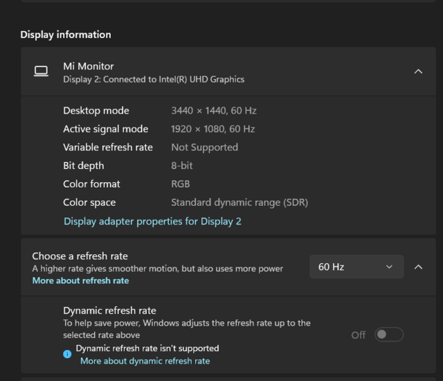

Hello again ToastyX, I'm a little frustrated with the 1215u laptop... suddenly I could get it to display 3440x1440 60 Hz with the USB-C to HDMI cable, but just that. I still can't set 100 Hz as refresh rate and I still can't get anything more than 1080p when using the HDMI port/cable to connect it to the Xiaomi ultrawide monitor. I'm guessing that an automatic display driver update from Windows screwed things for me...
I also discovered another issue with the 1215u laptop a few days ago; I can't get it to display 2k or 4k when connecting it through HDMI to a 4K TV, the max resolution option I get is 1080p 60 Hz. I'll contact the Walmart/Onn support team on Monday to ask them if they can provide a copy of all the laptop drivers and reinstall them to see if that fixes something and I'll also contact Intel as you suggested. Thanks a lot for your time and replies!
And about buying more cables... I don't know man, I'm thinking that maybe a new certified HDMI 2.1 cable may act different or the other one may help...

Man, this thing is absolutely crazy... I unplugged the usb-c to hdmi cable and kind of immediately connected the Hdmi to Hdmi cable on the same xiaomi monitor and I got this resolution, signal, don't know how to call this:
[Image: 17336420574882.jpg]
[Image: Screenshot-2024-12-08-011333.png]
I don't know how that happened but it's useless, the text looked all blurry and the displayed signal didn't even use the whole screen... I tried changing the refresh rate to 50 Hz but it reverted back to stretched 1080p and it isn't showing the 3440x1440 resolution anymore...
2nd edit... I tried something stupid and disconnected the usbc cable from the laptop and plugged the hdmi cable really fast and it happened again! got the weird 3440x1440 blurry and kind of useless resolution to show on the xiaomi monitor... these things are weird... Huh
