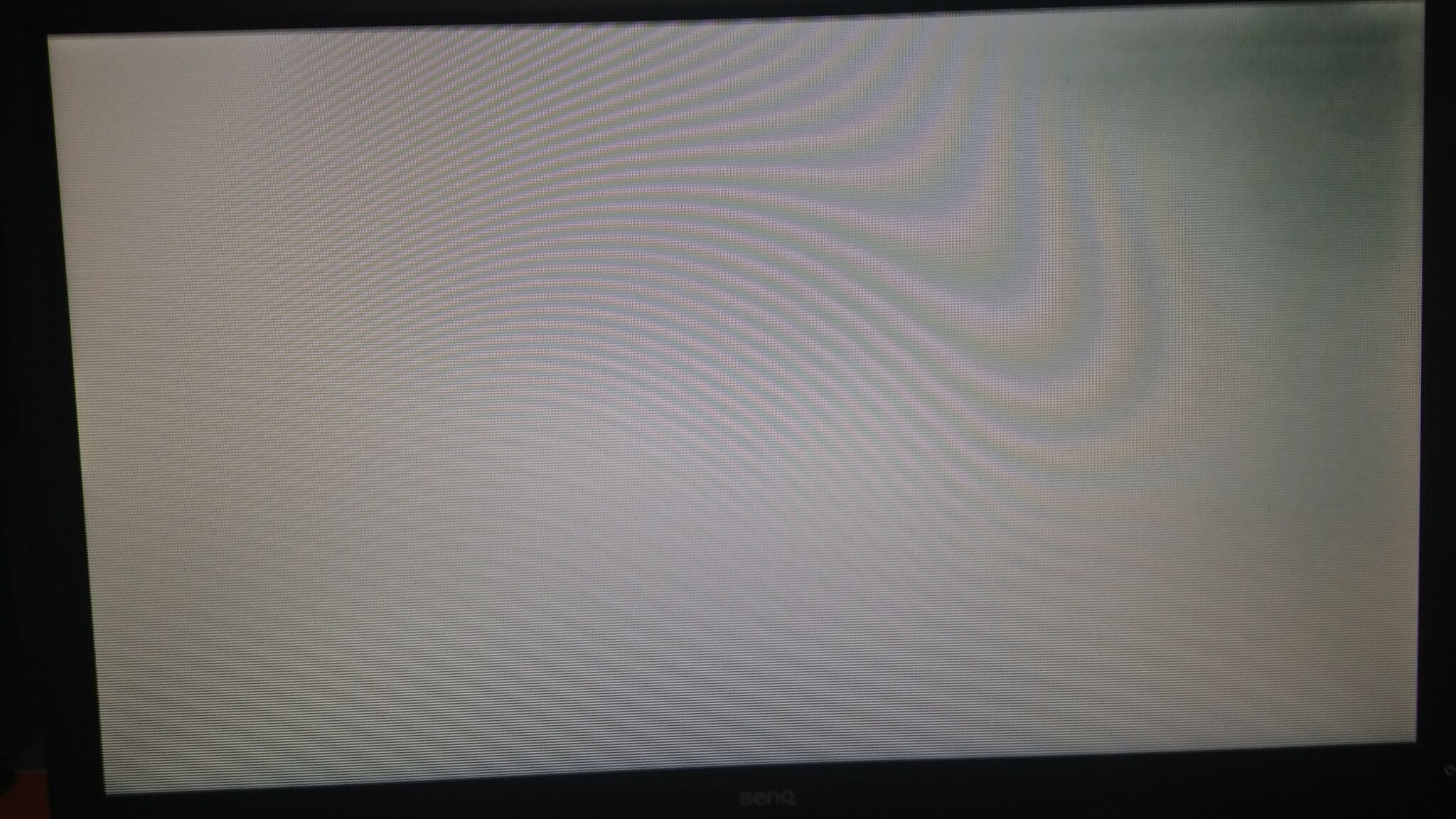

Now, whenever I try to set the refresh rate above 60Hz (100Hz, 120Hz, 144Hz), the screen scrambles and becomes unusable. The issue occurs on all resolutions. The monitor works just fine at 60Hz though.
This is what it looks like:
This is the service menu:

I don't see how the monitor would be damaged by those resolutions. It's more likely the monitor just broke on its own, especially with that many hours. Just in case the firmware is stuck in a confused state, try unplugging the monitor's power for a minute to reset it.

Yeah, I also suspected a firmware issue, since the problem has already occurred once before but was seemingly resolved after moving (extended time period without energy). This time though, the problem persists even after a night without electricity Sad.
I just find it strange that 60Hz works perfectly... but hey, I have little knowledge about the technical details concerning higher refresh rates.
